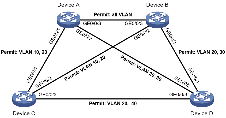

As shown in Figure 3, Device B and Device C are directly connected to a LAN.
If Device A forwards BPDUs to Device B through port A1, the designated bridge and designated port are as follows:
·     The designated bridge for Device B is Device A.
·     The designated port for Device B is port A1 on Device A.
If Device B forwards BPDUs to the LAN, the designated bridge and designated port are as follows:
·     The designated bridge for the LAN is Device B.
·     The designated port for the LAN is port B2 on Device B.
Figure 3 Designated bridges and designated ports

As shown in Figure 6, Device A is the root bridge. The priority of Device B is higher than the priority of Device C. Port C2 on Device C is blocked.
When the link between Device A and Device B fails, the following events occur:
1.     Device B sends an RSTP BPDU with itself as the root bridge to Device C.
2.     Device C compares the RSTP BPDU with its own BPDU.
3.     Because the RSTP BPDU from Device B has a lower priority, Device C sends its own BPDU to Device B.
4.     Device B considers that Port B2 is the root port and stops sending RSTP BPDUs to Device C.
Figure 6 BPDU processing in RSTP

As shown in Figure 12, Port C3 is an edge port connected to a host. When a network topology change occurs, the port can immediately transit from the blocking state to the forwarding state because no loop will be caused.
Because a device cannot determine whether a port is directly connected to a terminal, you must manually configure the port as an edge port.
Figure 12 Edge port rapid transition

As shown in Figure 18, Device A and Device B connect to two user networks through double links.
·     The spanning tree feature is disabled on Device A and Device B and enabled on all devices in user network 1 and user network 2.
·     Device A and Device B transparently transmit BPDUs for both user networks and are not involved in the calculation of spanning trees.
When the network topology changes, it takes time for Device A and Device B to update their MAC address tables and ARP tables. During this period, traffic in the network might be interrupted.
Figure 18 TC Snooping application scenario
To avoid traffic interruption, you can enable TC Snooping on Device A and Device B. After receiving a TC-BPDU through a port, Device A and Device B update MAC address table and ARP table entries associated with the port's VLAN. In this way, TC Snooping prevents topology change from interrupting traffic forwarding in the network. For more information about the MAC address table and the ARP table, see "Configuring the MAC address table" and Layer 3—IP Services Configuration Guide.

As shown in Figure 21, all devices on the network are in the same MST region. Device A and Device B work at the distribution layer. Device C and Device D work at the access layer.
Configure MSTP so that frames of different VLANs are forwarded along different spanning trees.
·     VLAN 10 frames are forwarded along MSTI 1.
·     VLAN 30 frames are forwarded along MSTI 3.
·     VLAN 40 frames are forwarded along MSTI 4.
·     VLAN 20 frames are forwarded along MSTI 0.
VLAN 10 and VLAN 30 are terminated on the distribution layer devices, and VLAN 40 is terminated on the access layer devices. The root bridges of MSTI 1 and MSTI 3 are Device A and Device B, respectively, and the root bridge of MSTI 4 is Device C. Device B has the lowest root bridge ID.
Figure 21 Network diagram
As shown in Figure 21, configure VLANs and VLAN member ports. (Details not shown.)
·     Create VLAN 10, VLAN 20, and VLAN 30 on both Device A and Device B.
·     Create VLAN 10, VLAN 20, and VLAN 40 on Device C.
·     Create VLAN 20, VLAN 30, and VLAN 40 on Device D.
·     Configure the ports on these devices as trunk ports and assign them to related VLANs.

Example: Configuring PVST
As shown in Figure 23, Device A and Device B work at the distribution layer, and Device C and Device D work at the access layer.
Configure PVST to meet the following requirements:
·     Frames of a VLAN are forwarded along the spanning trees of the VLAN.
·     VLAN 10, VLAN 20, and VLAN 30 are terminated on the distribution layer devices, and VLAN 40 is terminated on the access layer devices.
·     The root bridge of VLAN 10 and VLAN 20 is Device A.
·     The root bridge of VLAN 30 is Device B.
·     The root bridge of VLAN 40 is Device C.
Figure 23 Network diagram
As shown in Figure 23, configure VLANs and VLAN member ports. (Details not shown.)

When the network is stable, you can use the display stp brief command to display brief spanning tree information on each device.
# Display brief spanning tree information on Device A.
[DeviceA] display stp brief
 VLAN ID     Port                         Role  STP State     Protection
 10          GigabitEthernet0/0/1           DESI  FORWARDING    NONE
 10          GigabitEthernet0/0/3           DESI  FORWARDING    NONE
 20          GigabitEthernet0/0/1           DESI  FORWARDING    NONE
 20          GigabitEthernet0/0/2           DESI  FORWARDING    NONE
 20          GigabitEthernet0/0/3           DESI  FORWARDING    NONE
 30          GigabitEthernet0/0/2           DESI  FORWARDING    NONE
 30          GigabitEthernet0/0/3           ROOT  FORWARDING    NONE
# Display brief spanning tree information on Device B.
[DeviceB] display stp brief
 10          GigabitEthernet0/0/2           DESI  FORWARDING    NONE
 10          GigabitEthernet0/0/3           ROOT  FORWARDING    NONE
 20          GigabitEthernet0/0/3           ROOT  FORWARDING    NONE
 30          GigabitEthernet0/0/1           DESI  FORWARDING    NONE
 30          GigabitEthernet0/0/3           DESI  FORWARDING    NONE
# Display brief spanning tree information on Device C.
[DeviceC] display stp brief
 10          GigabitEthernet0/0/1           ROOT  FORWARDING    NONE
 10          GigabitEthernet0/0/2           ALTE  DISCARDING    NONE
 20          GigabitEthernet0/0/1           ROOT  FORWARDING    NONE
 20          GigabitEthernet0/0/2           ALTE  DISCARDING    NONE
 40          GigabitEthernet0/0/3           DESI  FORWARDING    NONE
# Display brief spanning tree information on Device D.
[DeviceD] display stp brief
 20          GigabitEthernet0/0/1           ALTE  DISCARDING    NONE
 20          GigabitEthernet0/0/2           ROOT  FORWARDING    NONE
 20          GigabitEthernet0/0/3           ALTE  DISCARDING    NONE
 30          GigabitEthernet0/0/1           ROOT  FORWARDING    NONE
 30          GigabitEthernet0/0/2           ALTE  DISCARDING    NONE
 40          GigabitEthernet0/0/3           ROOT  FORWARDING    NONE
Based on the output, you can draw a topology for each VLAN spanning tree, as shown in Figure 24.
